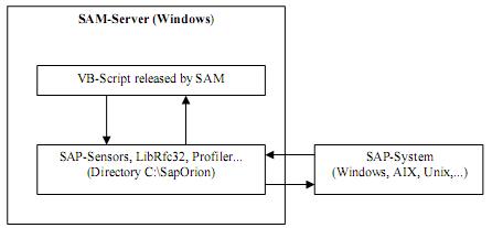

The SAP-Sensors are imbedded to ORION as shown:
- Within the SAM-Server, which runs under Windows, there is a Directory "C:\SapOrion".
- The Directory "C:\SapOrion" contains the Scripts, the SAP-Sensors, the Profiler and the Dll
- Within the Directory "C:\SapOrion" there have to be the Dll "LibRfc32.Dll"
- The SAP-Profiler, with is within the Directory "C:\SapOrion", could be run too
- On the SAP-System itself there is no Directory for the sensors needed
- The SAM calls the Script from the Directory "C:\SapOrion"
- The Script calls the SAP-Sensor which is also within the Directory "C:\SapOrion"
- The Sensor contacts the external SAP by using RFC and request the data
- Then the SAM could analyse the resulting
